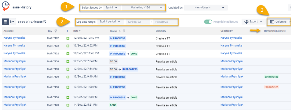

You can create this kind of report with Issue History for Jira if you are ok with add-ons. My team developed it to get a changelog of any field for the list of issues.
For your report, you need to:
1. Filter issues by Project, Sprint, Assignee, etc.
2. Choose the date range you need.
3. Add "Remaining Estimate" or other issue fields you want to monitor changes about. Use Column manager for this option.
Here is a 30-day trial to check if the app is good for you.
