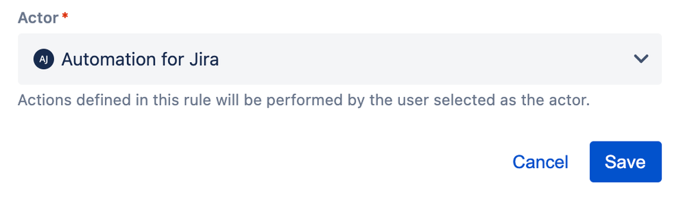

When creating a git branch I am moving a card from "SELECTED FOR DEV" to "IN PROGRESS" through an automation trigger. I would like to be able to limit that transition so that the only one who can move it is the actor of that trigger (the Jira bot). Jira defaults the actor of the trigger to be "Automation for Jira".

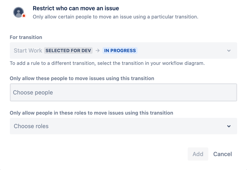

Transition restriction popup window:
Automation Rule displaying the Actor (unchanged from default):Screen Shot 2021-02-12 at 4.04.47 PM.png

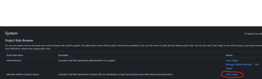

1) Find out what your automation id is:
    b) Click view usage for atlassian-addons-project-access
    c) the automation id is in the url

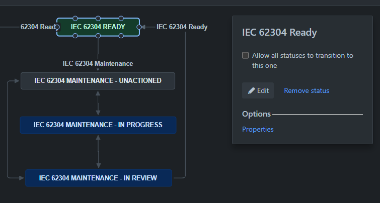

2) Go to your workflow, select the status you want to restrict transitions, click on the status then click on properties under Options

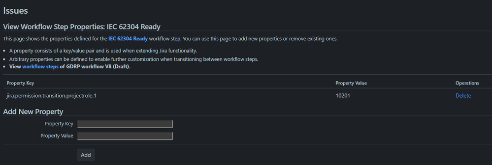

3) Add the condition for automation to have permission
   a) Set the property key to jira.permission.transition.projectrole.1
   b) Set the property key to the automation Id you obtained from previously
   c) click the add button
You're done!
Now, only automation will have permission to transition any ticket that has that status.
You will need to repeat the process for every status that you want to restrict to only automation.

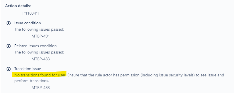

Hi George,
I've tried to manage the workflow permission like you suggested, but i still receive an error in the automation did by "Automation for Jira" user:
Any idea?
Thanks
George Bou-Rizk
November 3, 2023
I believe that is a permission that you have not enabled in your projects permissions.
In your project on the left navigation panel, Click "Project Settings", then click on "Permissions".
Try update the permission, "Transition Issues" to grant permission to:
Project Role: "atlassian-addons-project-access"
You maybe also "browse projects" permission. If in doubt just grant Project Role: "atlassian-addons-project-access" all permissions

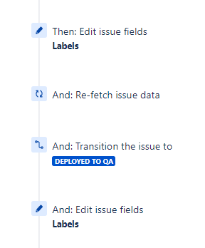

Hi! - I needed to do this as well, and figured out a workaround that may work on some situations. I can think of some scenarios where this may not solve your case.
In the workflow, the exclusive transition has a rule that allows the issue to transition only if it contains a certain label. In my case the label is "JiraAutomation".
Then, in automation, before using said transition, add the label to the issue, perform the transition, and then you can remove the label afterwards.
It is like marking the issue to enable the transition.
This works as a charm, because users won't see the transition in the list of available transitions, unless they manually add the enabling label. Just don't spread the word to the team.. haha!
Hope this helps someone!
Hugo Gómez
June 7, 2022
Update with new discoveries...

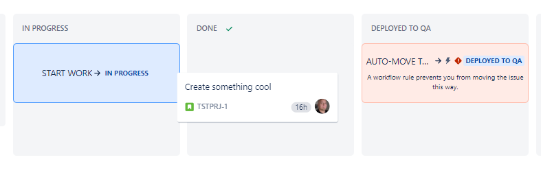

1. After assigning the label to the issue to transition, you must re-fetch the issue's data (there is an action for that)  before performing the transition, this will ensure the label is properly applied before attempting the move.
2. The experience on the Android mobile app (v93.1.1)  is not as good as on the browser app. In the browser the transition is highlighted as not available to user. (see drop zone on right)
jira-automation02.pngIn the mobile app, the transition IS allowed, then it is reversed after a few seconds. This indicates that the verification takes place after the move, and it is not prevented as in the browser app.
So far, that's about it.

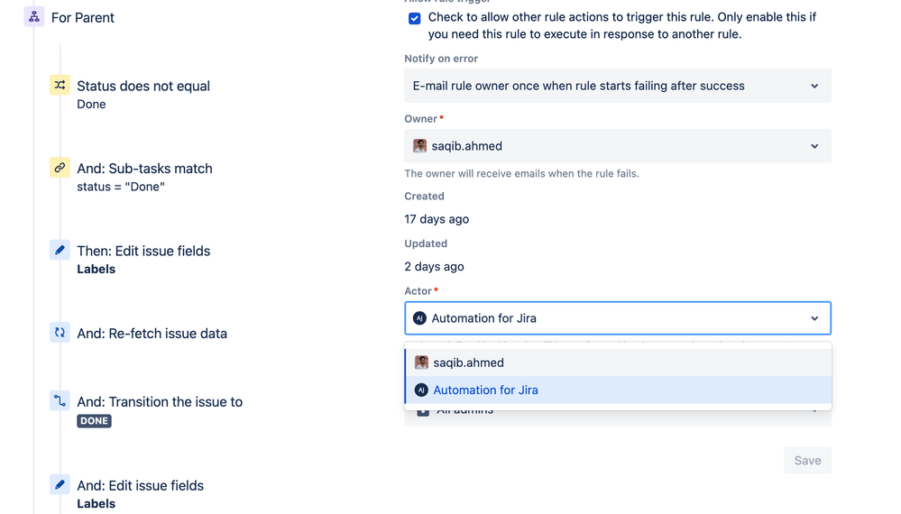

saqib.ahmed
February 6, 2023
@Hugo Gómez Instead of doing this whole workaround, isn't it easier to just use the admin user (or your own user) as the automation rule's actor? Then in the workflow, only allow the automation rule's actor to make the said transition.
At any rate, the user who's configuring the label to be added and removed can do that manually as well. With him being the actor of the rule, only he'd be able to make the transition either manually or via the automation rule. The same effect would be achieved as previously without any loophole.

In the workflow, to the transition I can apply "Rules", the one I wish to apply is "Restrict who can move an issue", I can't figure out how to allow only the Jira Bot (the trigger automation software) to make the transition.
