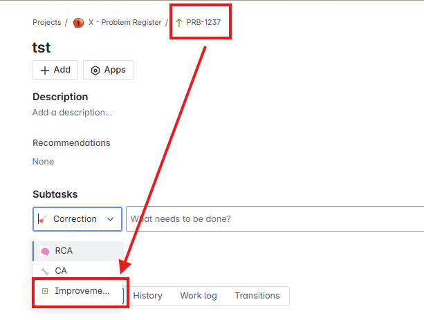

How to restrict subtask types to certain task type
Martin Vali

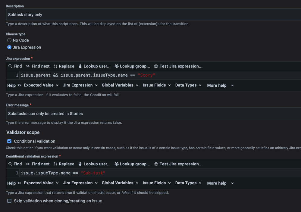

This should be possible using our tool, Jira Misc Workflow Extension (JMWE).
You may set up a validator on the "Create" workflow with specific conditions with your own validator.
Just select the option "Build-your-own Validator (JMWE app)" and select the JQL code option.
the code should look something like this:
issue.parent && issue.parent.issueType.name == "Story"
I used story as an example, but you are able to select any issue type available in the project scheme.
Then you check the box "Conditional validation" with the code:
issue.issueType.name == "Sub-task"
This guarantees that only sub-tasks fall into the condition, and other issue types are created normally.
Here is a screenshot of it.
You are also able to put the "Conditional" inside the code, that way you may add more to it.

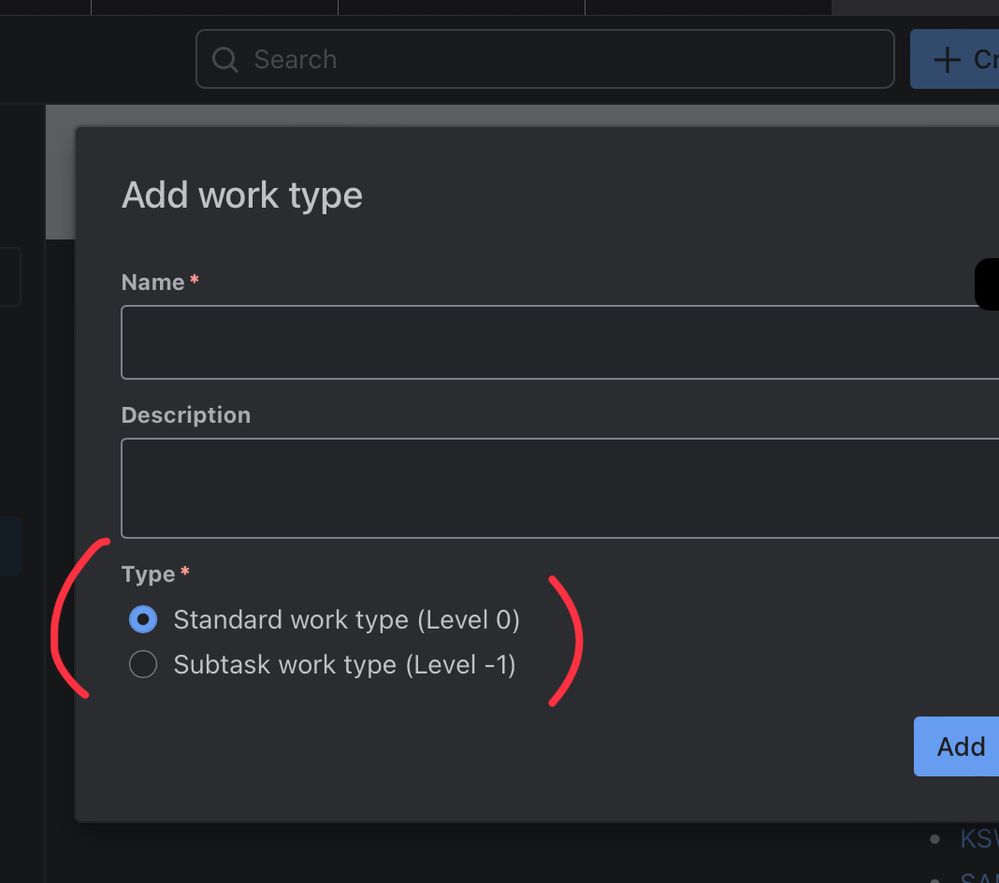

Hi @Martin Vali , I am not sure I follow your question exactly. When you create a new issue type you can decide if it is at level 0 (standard) or -1 (sub-task).
