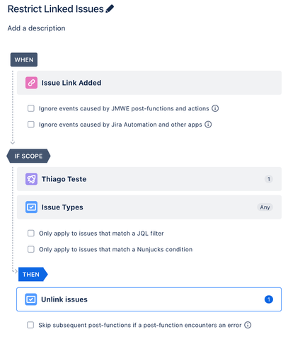

If you are considering third-party apps, you could easily create a rollback event-based action using JMWE(Jira Misc Workflow Extensions), here’s an example:
This action will restrict any issues trying to link with those matching the nunjucks criteria:
{{ issue.fields.summary == "Epic Link A" or issue.fields.summary == "Epic Link B" }}
However, keep in mind that the opposite will not trigger a link removal, that is, if you link from your restricted issue it will remain linked.
Please contact our support if you have any other questions about this.
Best regards, Appfire support team.
