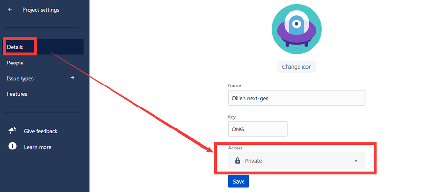

Hi @Ankit Gupta,
Have you ever tried configuring Access as private in Project settings?

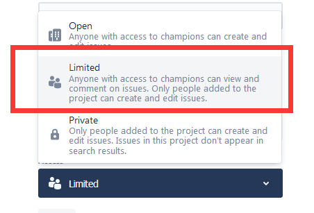

Hi @Joe Hankin ,
Have you set the permissions to be restricted and added this user to the access group for the next-gen project?
