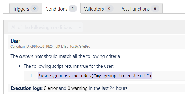

Aaron Morris
October 6, 2023
As others have already answered, this is not possible off-the-shelf.  You must use a third-party app to create a negative condition that prevents a specific user group from transitioning.
In addition to the suggestions from @Rezgar Cadro _Totem Dev_, I will add Jira Miscellaneous Workflow Extensions (JMWE) to the list of options.  I believe it is slightly less expensive than some of the others.  In JMWE, you can create a User Condition that uses a custom expression to create a negative restriction:
!user.groups.includes("my-group-to-restrict")
The completed condition looks like this:
And here's a Scribe I created with step-by-step screenshots.

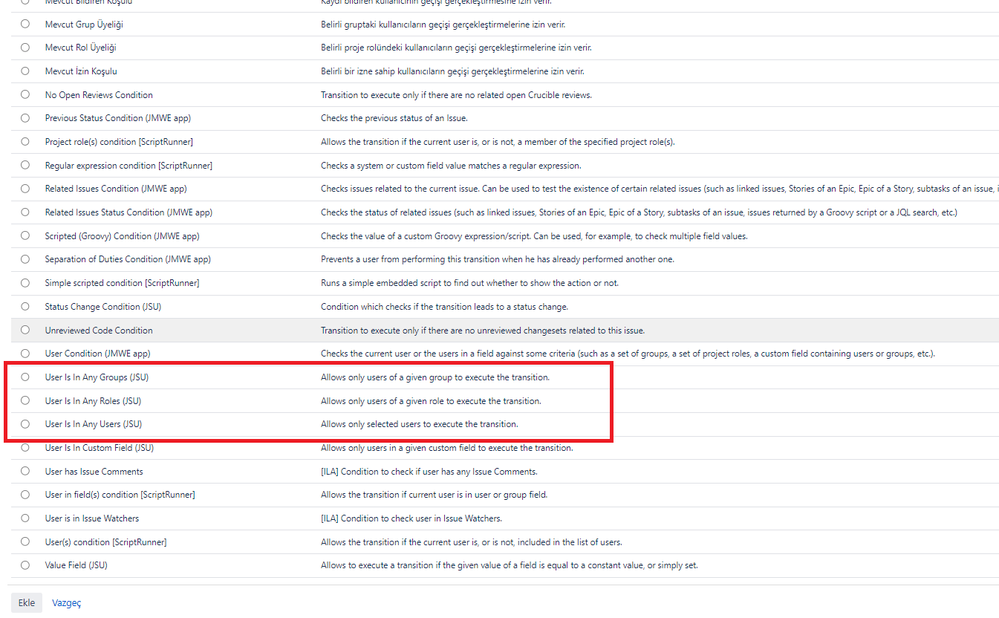

Igor Dugalic
October 6, 2023
It's the same in Cloud.
Condition -> User Is In Any Group (Condition to allow only users in a given group to execute a transition.)

Igor Dugalic
October 6, 2023
But you can add all the groups except the one that should not execute it.

Christopher Maxwell
October 6, 2023
Hi Bhushan,
You've got some good answers here. Only thing I would add is to make sure you are not using Simplified Workflow and are instead using Jira/Customized Workflow?
https://support.atlassian.com/jira-software-cloud/docs/use-the-simplified-workflow/
https://www.linkedin.com/pulse/simplified-workflow-vs-customized-jira-software-savio-david
If you are using customized workflow, you can add a condition to every transition that you want to restrict. For example, using the "User is in project role" condition:
