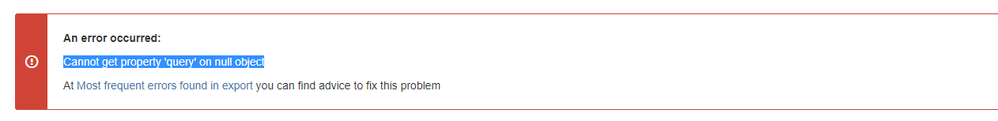

I am facing this issue while exporting a project in jira:
"Cannot get property 'query' on null object
I face this issue when i select the option "Shared with exported projects " in Filters to export and Dashboards to export.
My jira version is 7.3.8 and i am using jira configurator plugin to export a selected project in jira.
Please help me to resolve this issue.
Thank you

Hi Shriya,
Thank you for your question.
I can confirm that the error message above indicates that an agile board is being exported from the source instance which does not have a filter configured for it, as the filter associated with it has been deleted.
The workaround for this issue is to identify the agile board or board(s) which have an invalid filter which you can do by running the SQL query below in the JIRA Database on the source instance.
select b.NAME, b.SAVED_FILTER_ID, f.filtername, f.reqcontent
from AO_60DB71_RAPIDVIEW b left
join SEARCHREQUEST f on b.SAVED_FILTER_ID = f.id
where f.id is NULL;
Once you have identified the board with the missing filter you can then either remove this board or update it to use a new filter which exists before taking a new export to import from. The Atlassian article located here outlines how you can associate a new filter to the invalid board inside the database.
We are currently working on improving the message thrown when this error occurs and plan to release these improvements within the next version.
If this answer has solved your issue can you please accept it in order to mark this answer as correct for users who are searching for a similar issue.

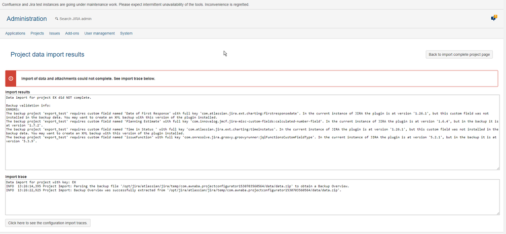

But now i am facing a new error. When i try to import a simple project from source jira to destination jira server with the help of project configurator, i am facing this issue which is somehow i feel related to custom field and plugins.
The plugins which are on source jira server are available on destination jira server as well. And the project which i am trying to import is very simple software project with only1 or 2 issues in it. Can you please help me to resolve this?
Thanks and Regards
Shriya Chhajed
Kristian Walker _Adaptavist_
July 9, 2018
HI Shriya,
The error shows that versions of the plugins are different between  the source and  the target instance.
In order to resolve this error you will need to update the plugins on the source instance to be the same as the target instance.
I have indicated below what version each plugin should be on the target instance.
  • ScriptRunner - Version 5.3.9
  • Jira Misc Custom Fields - Version 1.7.2
Also the error indicates that you do not have the Jira Charting plugin  installed and this needs to be downloaded from here and installed on the target instance before re running the import.
Thanks
Kristian
