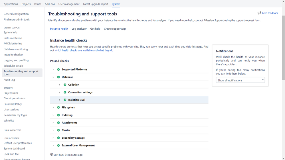

I have some problems about the configuration Isolation level for Jira database. My Jira version is JIRA v7.10.1 and database is MSSQL 2012, I configed mode READ_COMMITTED_SNAPSHOT is ON recording by recommend Instance health checks. But there are many problems of data deadlock like attachment. Please help me to resolve this!!
Many thanks!
https://confluence.atlassian.com/jirakb/health-check-database-isolation-834225506.html?_ga=2.181695520.643115483.1561897842-508274146.1561897842
Instance health checks after configuration DB:

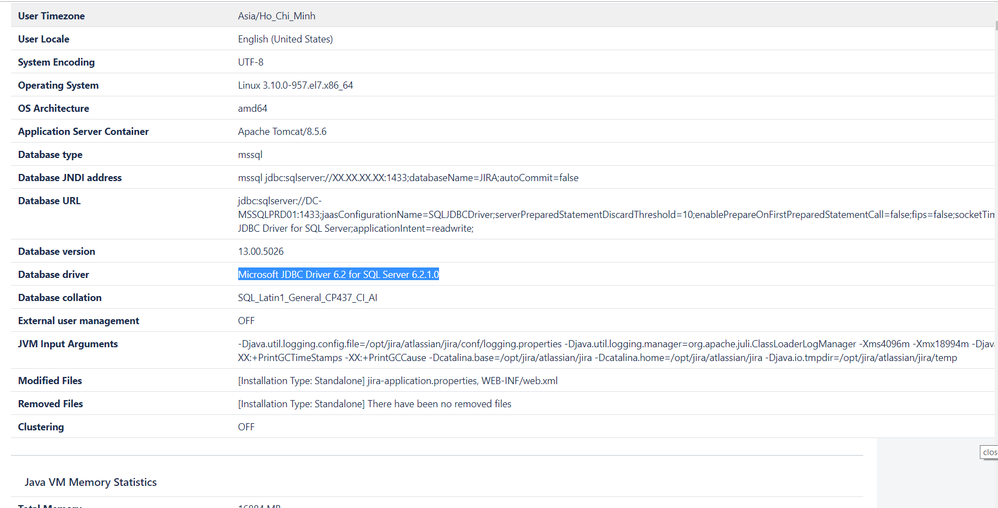

What is your connection string in the dbconfig.xml file?

mssql jdbc:sqlserver://x.x.x.x;databaseName=JIRA_DB;autoCommit=false

Ok, what SQL driver are you using?  Should be able to see it in the system information page.
Nguyễn Thành Hải
July 3, 2019

Ok, well, that's a fully supported version of Jira + Database + driver + connection string.
I think the next step is to find that error in the main log file and look at the errors that are occurring immediately before and after it.

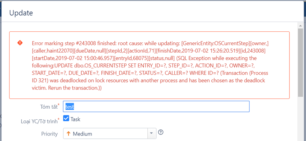

Yes, i already read the log file. There are a lot errors about deleting and updating OS_CURRENTSTEP table. So the deadlock has occurred, like the screenshot above.

So those errors could be leading to the deadlock, not the other way around.  You should examine them to see where they are coming from.
