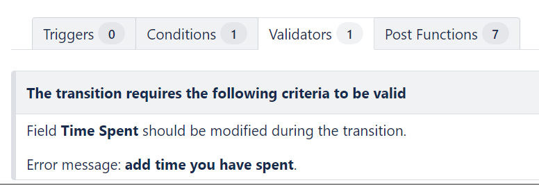

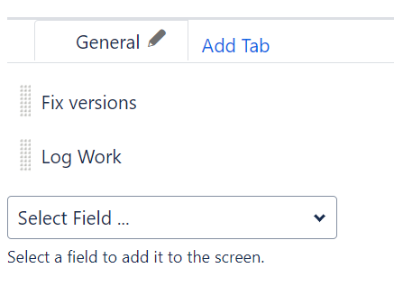

Two things I have noted while reading this:
  • On the screen that you display during the transition, reference the Log Work field.
  • On the validation step, reference the field Time Spent to check it should be modified during the transition.
Please note, I am testing with a Jira Cloud instance.
Let me know if I have misunderstood the requirements.
