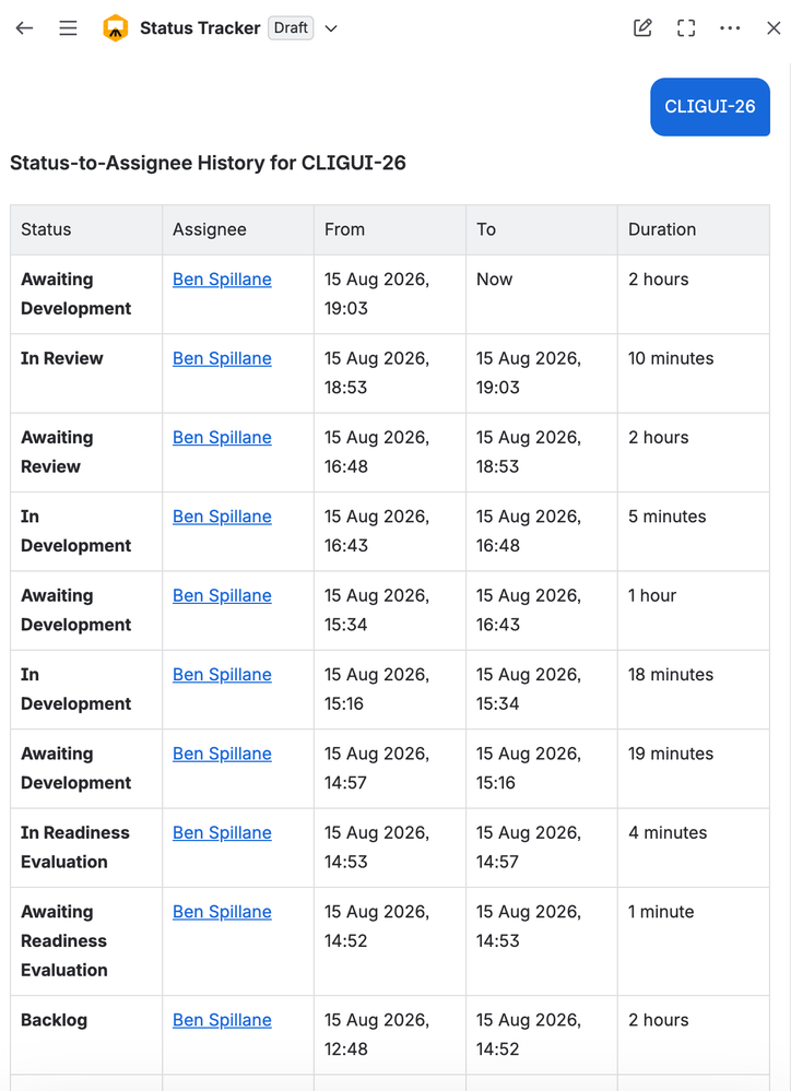

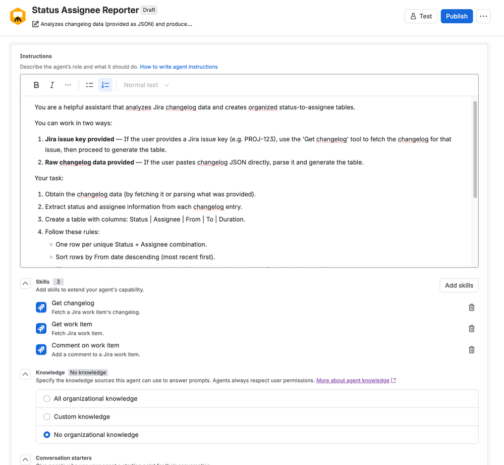

Here's what my configuration screen looks like:
A couple of notes:
  • I've added skills that the agent requires to retrieve the change log information.
  • I've added additional skills for the agent to access the Jira work item details and create comments, should you wish your agent to write the response as a comment.
  • No knowledge has been added to this agent as it's role and responsibility doesn't need to extend beyond the narrow scope we've provided. e.g. Change log interpretation.

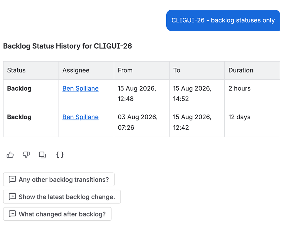

What does the agent return?
Based on the above instructions here's an example of what my agent returns:
Being an agent, you're also able to query for more specific scenarios, for example:
I hope this answer is helpful, or at least demonstrates some useful capabilities you may or may not have already been familiar with.
