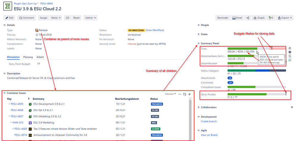

Hi @mdaintondcc ,
maybe something like a budget value may help you to store data over changes. Epic Sum Up (our plugin) does something like this:

Thanks @Andreas Haaken (APTIS) will have a look at your plugin.
