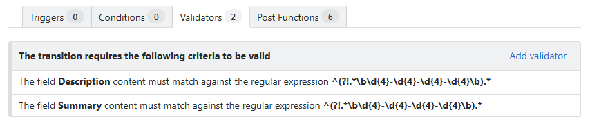

Anyway, I've played a bit with this a bit and the only solution I could come up with having these specific fields editable only on transition screens where you would have workflow validators that would check for an expression.
For example, let's say fields such as Summary and Description are only editable on create and status transition screens. 👈
On that, you can use Regular Expression Check validator to restrict transition if some of those fields contain a specific format (e.g. card number formatted 1234-5678-9012-3456).
*I've used the expression:
^(?!.*\b\d{4}-\d{4}-\d{4}-\d{4}\b).*
but AI is your friend here when it comes to writing regex.

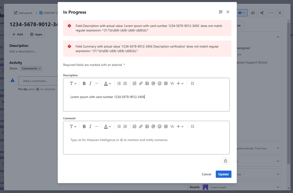

This would result in something like this:
If a user tries to create or update these fields of which one or both contain this specific string format, they would get an error message and can't finalize the transition/creation. > Therefore, it wouldn't be added to the issue history.
