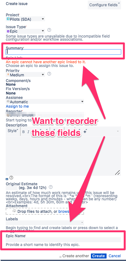

It seems that I am using a Custom Issue Scheme and this has a Custom Screen, which feeds on from a Default Screen from what I can gather.
However, for Epic Task Creation, I would like my fields reordered. Is there any way I can reorder and view the fields associated just with creating a specific Issue Type?

Thank you! This worked to an extent (Epic Name is higher up but not above Summary though). The issue was the following:
  • Both Tasks and Epics use the Default Screen
  • The Default Screen puts a Summary above the Epic Name.
  • Because an Epic is different to a Task, it makes sense to put Epic Name above the Summary. However, if I do that, the Task will suddenly also be reordered to have the name of the task just below the Epic involved.
Maybe I can create a new screen just for Epics vs. Tasks? But I think this might be overkill.
