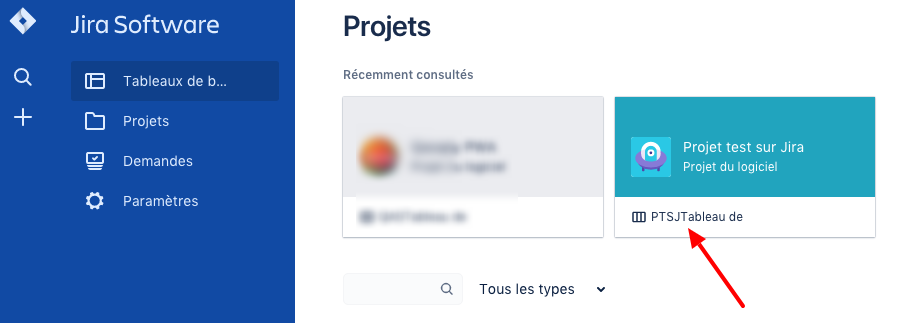

Hi,
Please, I would like to know if I can rename this auto generated shortname "PTSJTableau de" who appears under the project box ?
Thanks in advance ;)
You are looking at the name of the Agile board associated with the Projet test sur Jira. Renaming the board itself should change what you see there.
To do so, just click the link PTSJTableau de. it wil take you to the board itself.
Then, click the button with the 3 ... at the top right of the screen and click "Board Settings".
Over there, you will be able to change the board name:
