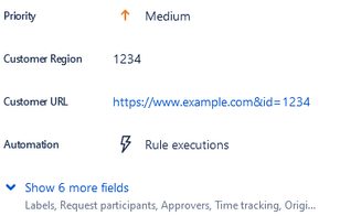

from the looks I solved the riddle - but please do an own test. Happy if you can confirm if it is what you were looking for.
I am just showing the difference to your JSON snippet, do let me know if you need further information:
"fields": {
"customfield_10082": "https://www.example.com&id={{customfield_10081.format("###")}}"

Erdős Zoltán
January 12, 2021
Hi Daniel,
Thank you so much, it is working!
