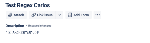

Hi @Łukasz ,
I tried in Cloud and Server instances and when I saved the regex it didn't change the formatting:
Is this something that you see consistently when creating Jira tickets containing regex expressions? (or maybe I misunderstood)
Screen Shot 2022-01-06 at 5.48.42 PM.pngScreen Shot 2022-01-06 at 5.46.19 PM.png

Hi
@Carlos Garcia Navarro @Craig Castle-Mead Thank you for your quick response.
I found cause of this case. If put dollar character as last, code block does not work, but if i put whitespace character after dollar character like space, pattern is saving correctly.
