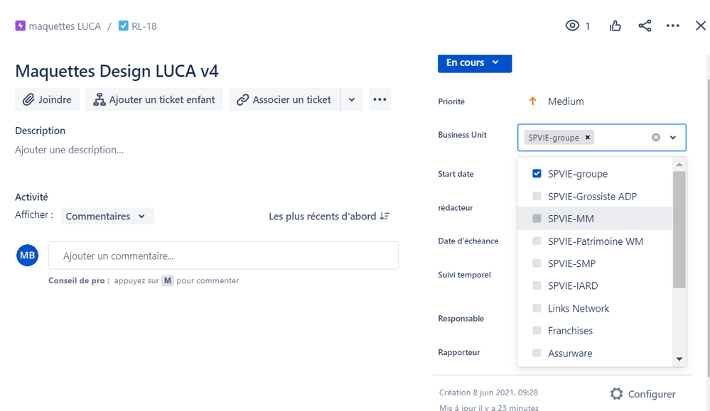

1) We managed the first step : here is a screen of our custom fied for Business Unit listing :
As you can see, it is properly set in the Ticket with many choices.

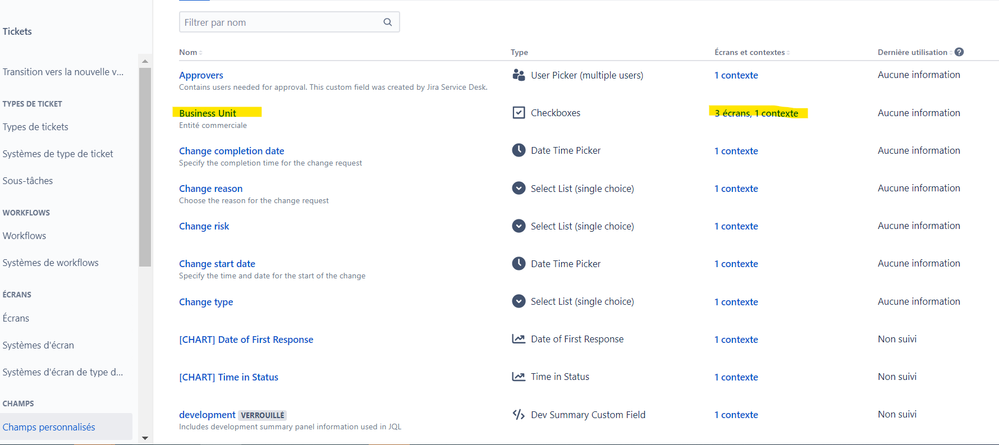

2) This is how we set it in Jira configuration : is everything OK?
should we keep 3 screens, 1 context (écrans in french) ? what does it means ?

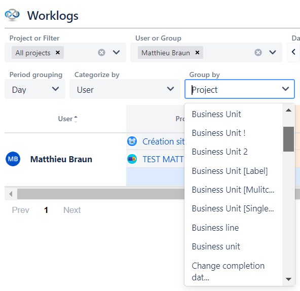

3) back in Worklogs extension on the main report area, we have a long list of Business Unit category and we're a bit lost : it seems we have multiple naming for "business unit"...
How can we clean this list to just keep main the main value Business unit and remove Business Unit ! , Business Unit 2 ... ?

In Worklogs you see the list of all custom fields in Jira, this includes global custom fields as well as custom fields from team-managed projects (used to be called next-gen projects).
In team-managed projects, these fields can be created on a per-project basis. Worklogs will treat it as the same field if they have the same type and name, however as I can see on your screenshot you have fields with different names as well as different types of the Business Unit field (label, single-select, etc.).
The only way to clear this up as far as I am aware is to go through the team-managed projects and make sure this field gets consolidated (it has one name & type).

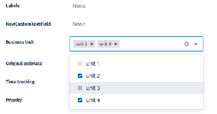

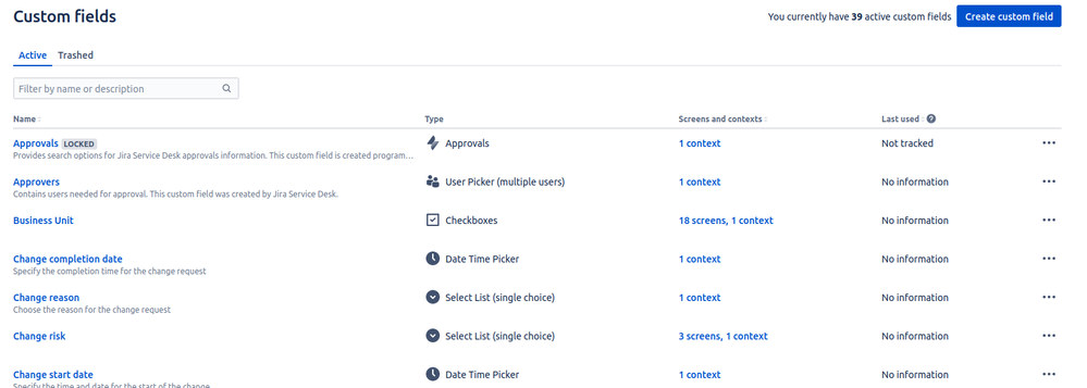

Custom field configuration:
Custom field in action:

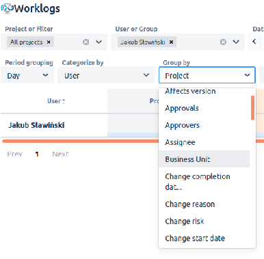

Worklogs in action:
Can you double check that you do not have these custom fields in other schemes?
