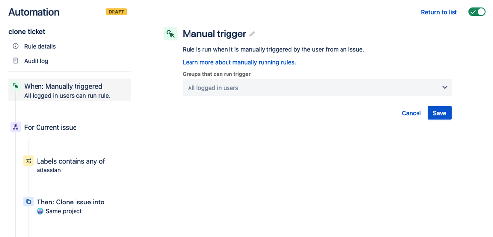

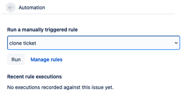

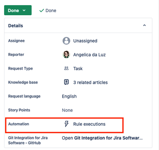

When creating a global or a project rule, the automation will always try to execute the rule due to the trigger. Since the trigger is "When a ticket is transitioned to Done", all tickets that are transitioned to this status will fall under that automation rule.
In this case, since you are using a Free site and there is a limit, my suggestion would be to use a manual trigger, so when the ticket needs to be Cloned, you or your teammates manually execute the rule.

Hope this helps!

Ah, yes this is helpful. I didn’t realize there was a manual options. Will manual only run a single run then?

Yes, the manual trigger will only count if someone clicks to run it.
