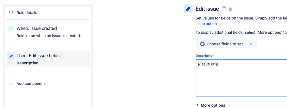

You are on the right track, this can be done with automation and is fairly straight forward. You can get the URL by using a smart value, {{issue.url}}, and then set that to the custom field like this:
Screenshot 2023-10-05 at 8.35.04 AM.pngIn this example I used the description field, just change that to your custom field.

Hi @Mikael Sandberg ,
thx for this warm welcome to the community:-)
Perfect start I'd as by following your suggestion we succeeded.
Thx
BR Andreas
