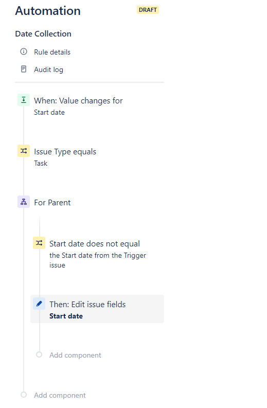

I'm trying to make automation that will choose earliest date from child ticket (start date field) and copy it to Parent ticket start date.
For instance Parent “Start Date“ = 01.02.2020, Child “Start Date“ = 01.01.2020, Child “Start Date“ = 01.03.2020 → Parent  “Start Date“ = 01.01.2020.
I've created automation that collecting date from Child and adding to Parent, but it collect just any date,  now it needs to be earliest date.
If anyone knows some JSON formula or Smart value and wants to share, that would be appreciated. Thank you in advance.
Current automation looks like this:
Bill Sheboy
December 16, 2022
Hi @Sinisa Glusac
To confirm the problem you are trying to solve...you only want the Parent to change to the earlier date if a Child issue has one.  Is that correct?
If so, couldn't you change your advanced compare condition in the branch to:
  • first value: {{triggerIssue.Start date}}
  • condition: less than
  • second value: {{issue.Start date}}
If instead you need the earliest date among all child issues, consider using Lookup Issues instead with JQL.  That will handle the case of an issue changing parent when the dates do not change...and that may required a couple of rules with different triggers: field value changed for Start Date, and issue updated for a change in parent (both the incoming and outgoing parents could need updates).
Kind regards,
Bill
Sinisa Glusac
December 16, 2022
Hi @Bill Sheboy yes, this is correct, and I tried your solution, it works perfectly. Thank you very much for your help and also thanks to Jack for his suggestion!
Like Bill Sheboy likes this

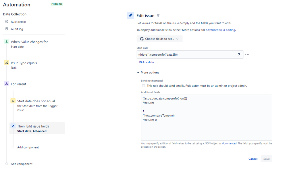

Sinisa Glusac
December 16, 2022
Hi Jack,
thank you very much for your quick response!
However, I tried your solution, but it must be that I did something wrong (lack of Jira experience). No error in audit log, just "no action performed".
Is this how automation should look like:
