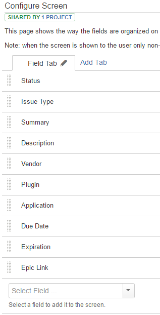

You can add more fields to a screen, like a data picker. You have to create or make sure you have a field that you want to use first. Check you Custom fields and see if you already have one, and then you can configure the screen you use for Create.
Go into your project administration area. Select Screens from the left menu, look at the issue type you want to add the field to. There will be a pencil to the far right, click on that and then click on the link listed under screen. It will bring up a list of fields that are associated with that screen. Add your field in Select Field box
Once you have done that you can test it by creating a new issue from the Create button within the project. There is a button called Configure Fields. You can check fields to be displayed in the form, if they are added to the screen.
