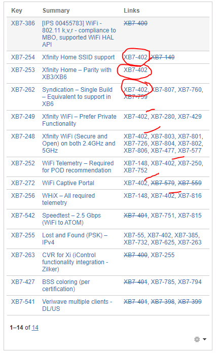

I'm using the two dimensional filter to display the Tasks, New Work or etc and they're related Linked Issues. But I only want to display Linked Issues that are Defects.

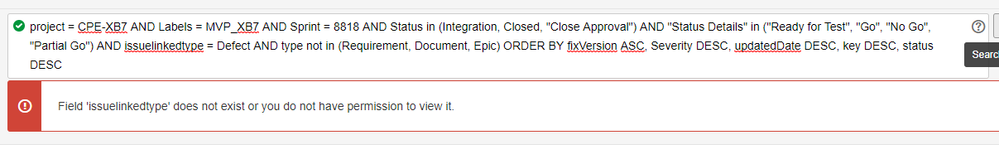

@Lorenzo Ferguson And by the photo you shared it's not issuelinkedtype...it's "issueLinkType" make the caps and spelling correct and retry once
@Kevin Johnson
That doesn't make any difference. It seems that isn't recognized either.

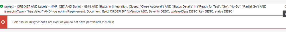

@Lorenzo Ferguson mention the issueLinkType that you would like to filter and then hope it works ..!
Create a normal filter and in last add if it's type is like defect .
E.g. and issueLinkType = "has defect"

Hey @Kevin Johnson ,
How exactly would I frame that in my query? I don't see an option for it
@Kevin Johnson
Here's my query.
The part is BOLD is where i'm trying to use the filter but have it ONLY show linkedIssues that are defects or omit certain issue IDs i.e. (XB7-402)
project = CPE-XB7 AND Labels = MVP_XB7 AND Sprint = 8818 AND Status in (Integration, Closed, "Close Approval") AND "Status Details" in ("Ready for Test", "Go", "No Go", "Partial Go") AND issue in linkedIssues("") AND type not in (Requirement, Document, Epic) ORDER BY fixVersion ASC, Severity DESC, updatedDate DESC, key DESC, status DESC

Then I want to display the results of the filter to show the following columns (Key, Summary and Links (ONLY display Linked Issues that of of the defect type)
The image I shared previously is what I want to see WITHOUT displaying the non-defect issues i.e. XB7-402.
