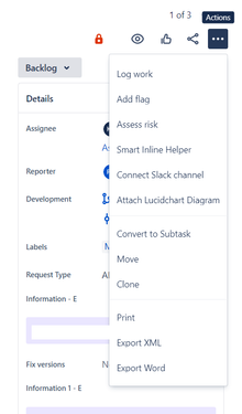

Hello, I'm trying to follow the steps, but I cannot see "Bulk change all issue(s)" under the pulldown menu here. Does it need to be handled by a Jira admin in my company?

Follow these steps:
1. Backlog> Press Command button (if you are using macbook) to select multiple issues
2. Right click and this drop down menu has the "Bulk Change" option.
3. Follow the steps shared by Utkarsh Singh above.
