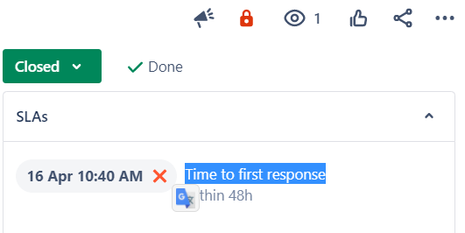

Hi,
In the service desk project, some of the assignees couldn't resolve the issue within the SLA determined time. However, I want to change the First Response Time to maintain the SLA time limitation. I want to modify the time the assignee responded to those issues for the first time. I want to modify this Date and Time 16 Apr 10:40 AM.

if you are asking about recalculating SLAs, while you can do this for open issue by updating your SLA rules this will not modify the SLA for any Done issues. If an issue is moved to Done with a breached SLA it will remain breached in accordance with the rule at the time it closed.

@Michael Hart , yes your #3 is correct.
I suspect the thinking here is that when an issue is closed the SLA has a final calculation based on the then current SLA configuration. So in fact, the SLAs for those closed issues are correct at the time of closure. For any issue that is still open you would want the new SLA configuration to apply. At least this is how I see it and I suspect is the same logic that the Atlassian development team considered.
