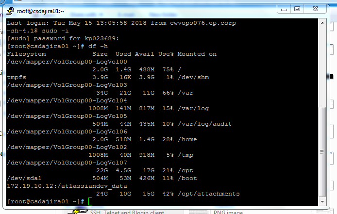

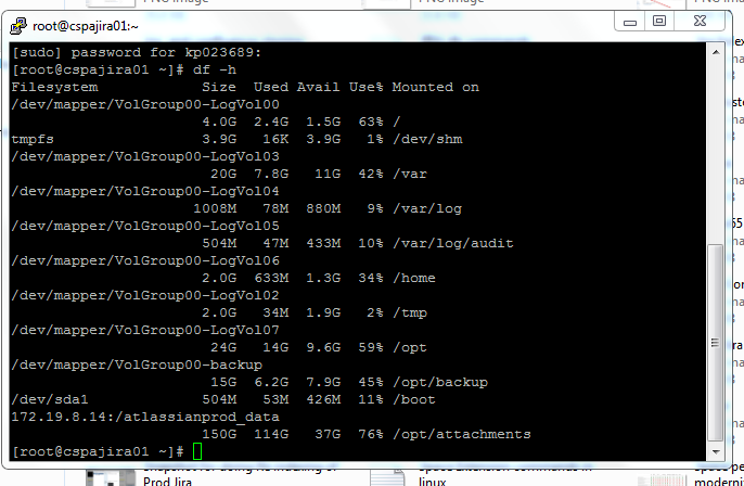

kedar
June 3, 2018
Please look my server details of both dev and prod jira space details.
Csdajira01 is dev jira and cspajira01 is my prod jira .i didn't find any attachments in /var/ .
I finded attachments in /opt /attachments which is NFS node point but this /opt/attachments contains bit bucket attachment,confluence attachment,jira attachment so how i have to move this attachmnets to dev jira .please have a look at attached snapshots and do a need full help.SAVE_20180531_105458.pngSAVE_20180531_105359.png
