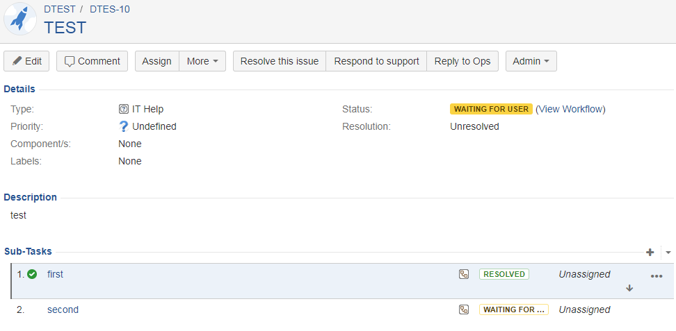

It would be the latter. Where they are similar sub-tasks in which they share the same flow and parent issue. Hopefully this image better gives you an idea what I'm trying to do with me previous description (statuses are different though but same idea when the "first" subtask is done, the parent issues defaults to the status of the "second" subtask.
I hope I'm answering it clearly for you but if not, please let me know.

Yes, that is correct for the "First" subtask. Currently, I have the flow setup to transition the parent issue based on the transitions of the subtasks. So if subtask is "In Review" the Parent transitions to "In Review" except for "Done" which the Parent issue won't transition to until all other subtasks are "Done".
What I'm trying to achieve functionally is when the "first" subtask reaches done, I want the parent issue to change it's status to the current status on the second subtask. So like the screenshot provided, the first subtask is "resolved". I want that transition to kick off the parent transition to the "Waiting for User" like the second subtask.
