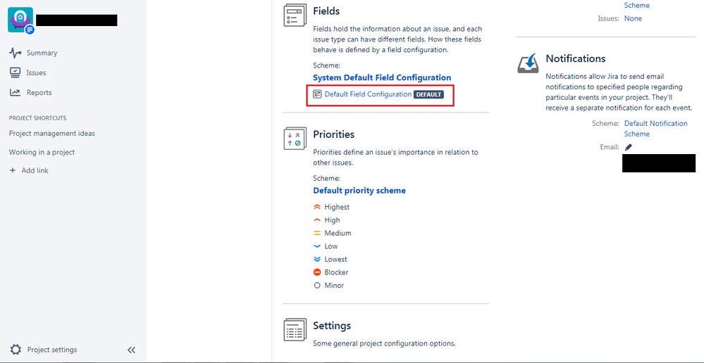

Hi @priyanka.raha
Go to the Project Settings and in that select Field Configuration Scheme, Field Configuration 1.png
Then select edit to edit the description and select required option to make the field required.
