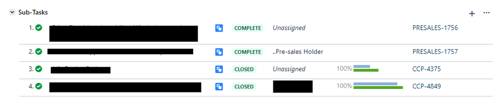

Anne Gallant
September 25, 2023
At one point Jira allowed you to do this because I have server data that does this exact thing.
Nic Brough -Adaptavist-
October 7, 2023
Jira has never allowed you to do this.  Your screenshots are not showing sub-tasks in different projects, the issue keys to the right of the display are coming from links or a field holding issues.
