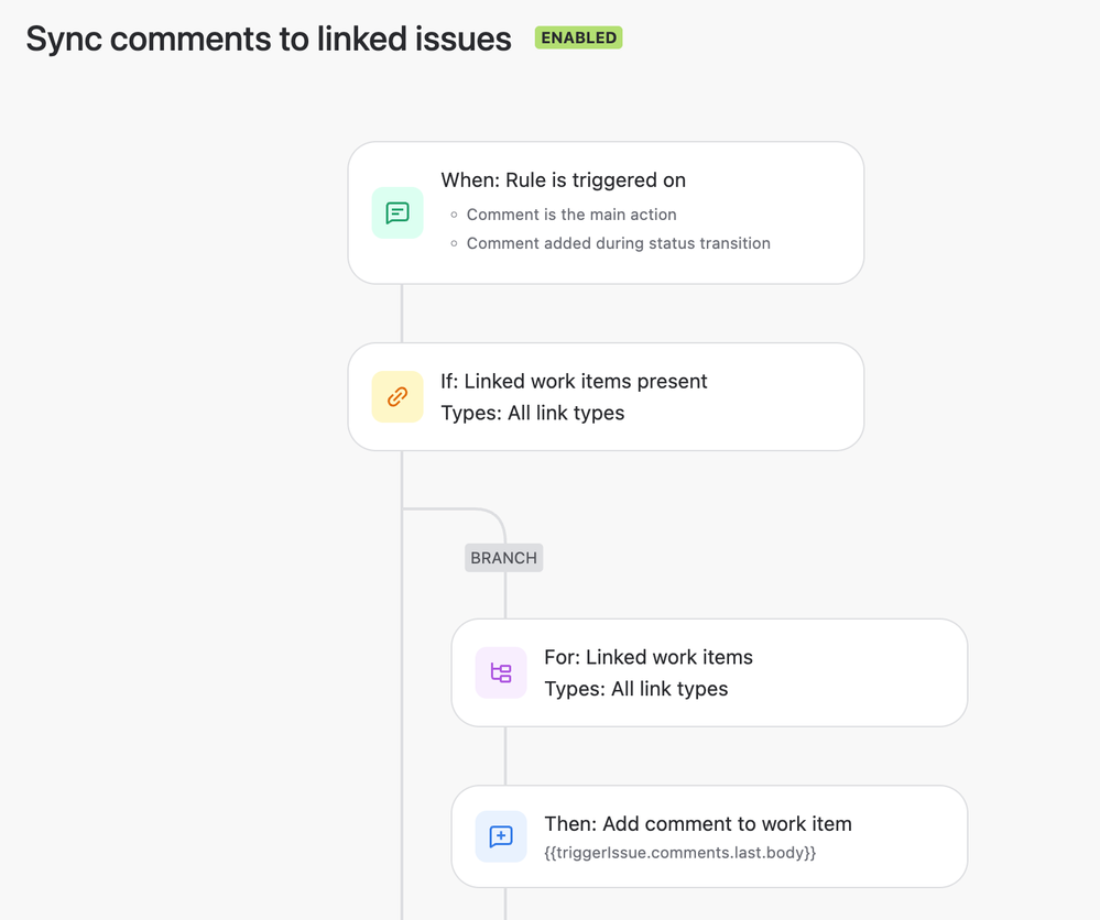

To give you a sample rule:
It is not exactly what you need, but the structure is quite relevant.
Suppose you want to add a comment to linked work items when the status of an item changes, all you would need to do is:
  • update the trigger to Work item transitioned
  • change the text of the comment you would like to add on the linked issue
  • (optionally specify the link type in the condition at step 2, so it only adds a comment on specific linked items)
