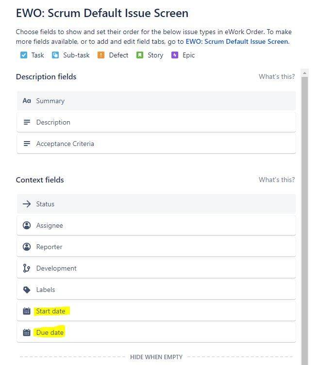

This is how I indicate in the Default Issue Screen to visualize both Start Date and Due Date:
dueDate_Jira.JPGin the Default Issue Screen, then I can see Start Date, but not Due Date, I can add Due Date in the card layout in the board, so the field is there, but in the issue detail view the information doesn't show:dueDateEpicDetail_Jira.JPG

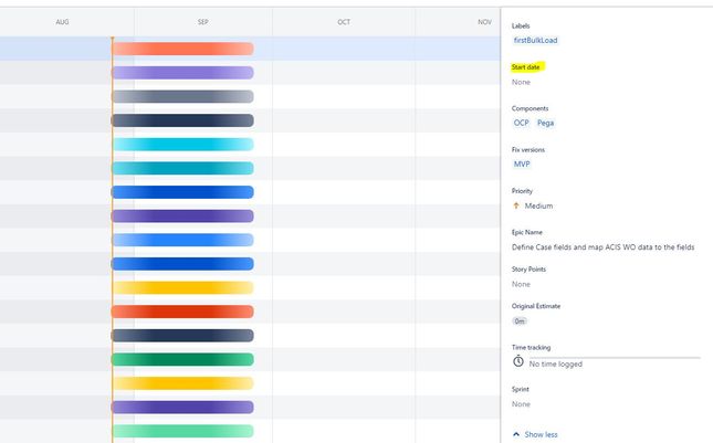

so because I am no able to set up both values I can not move the bars in the roadmap, and it shows:
No Due Date, No Start Date in the roadmap, so I can not move the epic in the time-schedule.

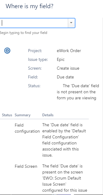

I was trying to create a new epic issue, then to add DUE DATE field, i.e. Create->Configure Fields->Where is my Field?-> Add DUE DATE in the search box. Jira is able to find it, but it shows the following message about it:

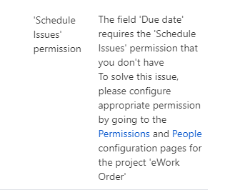

so the issue may be related with my user or Permission. I am the Jira Admin, but I did not add myself as a member of the project, so I did it as Administrators and the problem persists. Then I realized that maybe the issue is the Permissions and for Schedule Issues permission only the following roles have it:
  • Project Role (atlassian-addons-project-access)
  • Project Role (Scrum Master)
so Administrators don't have such permission, then I changed my role to Scrum Master and finally, I was able to drag and drop the epic in the RoadMap:

@David Leal I am glad you found the solution for this. :) and Yes, I forgot to mention this in my previous response. For setting up the Due date field, you need to have schedule issues permission. I know with lot of permissions in place , it can be frustrating at times.

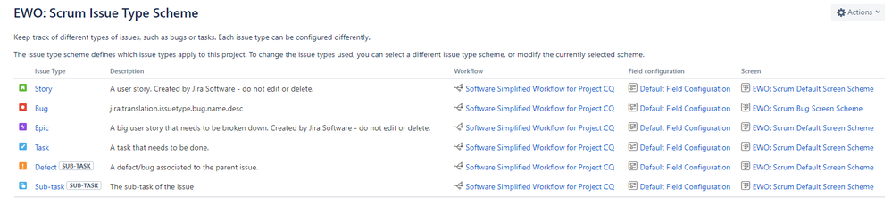

I am afraid that this is not the root cause of my problem. I am one of the Jira Admin.

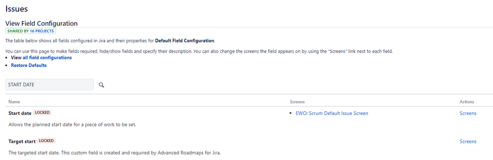

This is my Field Configuration:

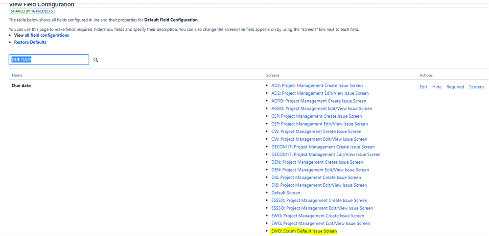

The DUE DATE field is there and I see my project screen assigned:
In my Issue Type Scheme I am using he project default Scren Scheme and the Default Field Configuration:
image.pngRegards,
