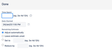

Hello,
I am trying to make the " Time Spent " field required in the resolution screen i added to the Workflow. The resolution screen pops up with as I attached below but it is not required. Thank you.
Trudy P Claspill
January 24, 2023
You need to update the workflow transition that uses that screen to make the Time Spent field required.
In a workflow used by a Company Managed project you would add a Validator.
https://support.atlassian.com/jira-cloud-administration/docs/configure-advanced-issue-workflows/#Validators
For a Team Managed project it is not currently possible to make Time Spent a required field.

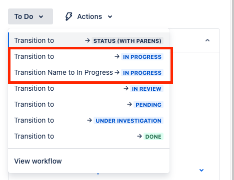

To get assistance with your problem please start a new Question and provide all the details with screen images of
- the entire workflow that shows all the transitions
- details of the Validators of the specific workflow transition that you believe is not working
- a screen image of the Status pull down for an issue that includes the transition you believe is not working correctly, like the one below, where we can see if there is more than one transition path to the specified destination status.
