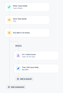

If I'm understanding correctly, you'll probably need a couple automation rules to achieve what you're looking for:
  • One for when the Daily Task is linked to the Existing Issues - Copy the Due Date on the Daily Task to those Existing Issues
  • One for when the Due Date changes on the Daily Task - Copy the new Due Date from the Daily Task to all the linked Existing Issues.
Another thing to consider is that the "source" issue when linking issues is important for the automation to work. So the first rule will only work if you are linking the Existing Issue to the Daily Task, not the other way around.
Of course, you can add another automation to handle that scenario as well, but this should get you on the right track.

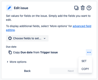

Thank you for your kind answer, but now I have a problem in not knowing what I have to write as a smart value. What should I write?
Bryce Lord
January 15, 2025
Of course! If you select the ellipses (...) on the right side there should be an option to "Copy" from a field value, and then select the trigger issue.
Like • MultiTime likes this
MultiTime
January 15, 2025
Oh, it works. Thank youšŸ˜„šŸ˜„
