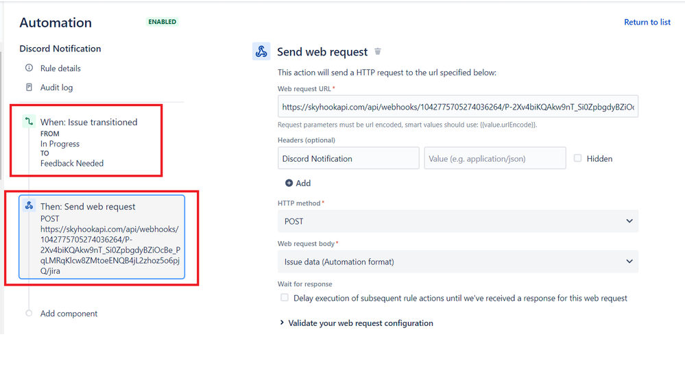

Hello,
I'm trying to make Jira send a notification to discord any time an issue's status is changed to "Feedback Needed". This is an obvious notification for QA.
I've found the trigger in automation ("Issue transitioned from "In Progress" to "Feedback Needed") and tried to set this up (see screenshot) with a webhook from Discord/ https://skyhook.glitch.me/Untitled.png
However, there is no reaction from Discord. What can I do?
This webhook has been added separately on Jira and it works, but the notifications from there do not allow "status changed to X" as a trigger, nor are the notifications' actual words customizable.

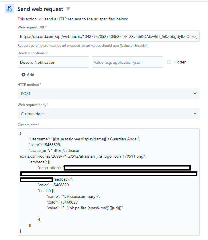

Dear all,
I've solved this by writing the custom data in JSON (see example below) and everything worked without third parties.
 Might be dumb to y'all but I'm not from IT, so coding is a completely new thing:)

Hi @Cristian -- Welcome to the Atlassian Community!
To clarify a bit, are you describing that your rule is not triggering, that there is not response to the webrequest, or something else?
Perhaps showing the audit log details for when this rule runs will help reveal something to explain the symptoms you are observing.

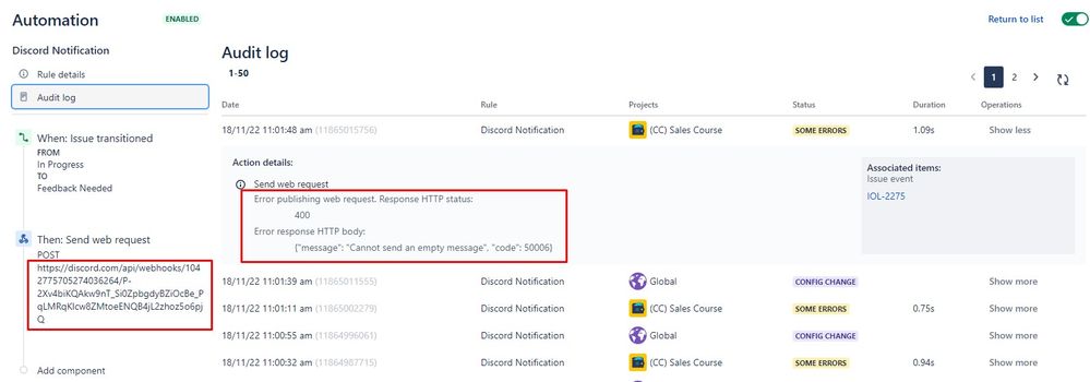

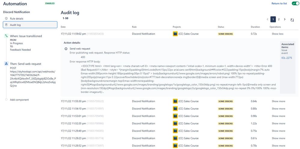

Cristian
November 18, 2022
Hello! Thanks for the reply. I mean that the change is made on Jira, but no message appears on Discord. There is nothing that happens on Discord, even though the event is supposed to be triggered and send a message.
Here's the audit log:
The error is the same everywhere.

If I try to use the regular Discord webhook (without going through skyhookapi), I get the following error:
