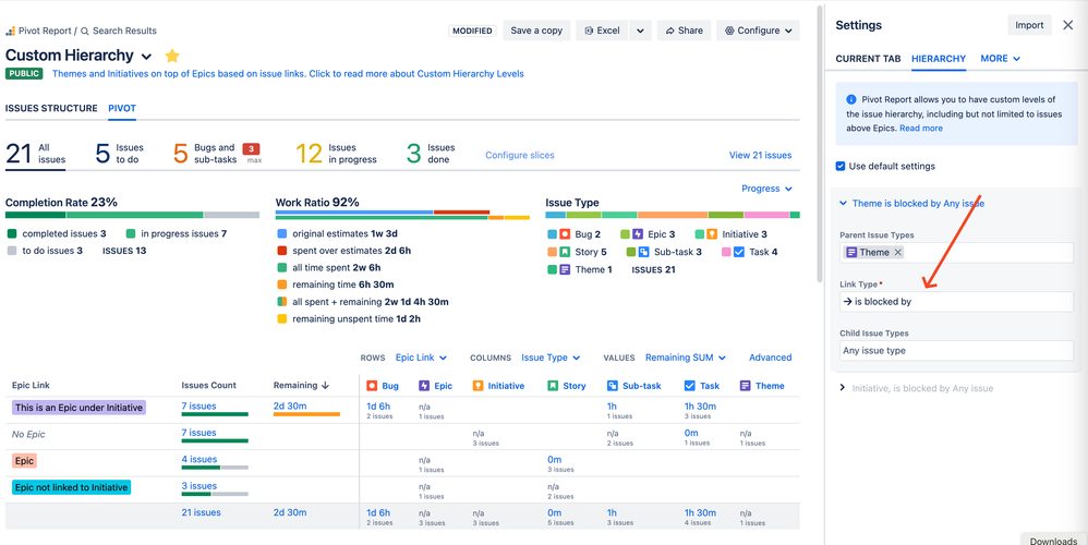

That sounds more like a custom report, since Jira is not really good with using links as a source in search. E.g. you can search for issues of the certain type from the specific project OR issues with links of a specific type.
If you are ok to use Marketplace Apps, take a look on Pivot Report we develop:
As you can see on the screenshot, we can define custom hierarchy using issue links. And then we can extend the initial search results with parent and child issues if needed. Another thing is that you can set grouping via rows to whatever is needed with up to 5 level. E.g. It could be Epic link, then Assignee and Issue Type.
You can check demo report here
