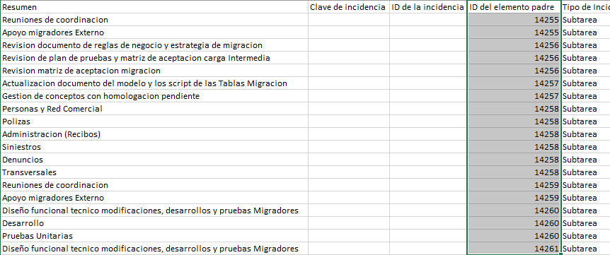

Emilio Silva
March 27, 2019
Hi, i'm expect this thread still open.
We're in JIRA cloud and i need to import a CSV with subtask (subtarea) so, i write in "ID del padre" column (parent ID) the task ID, that i uploaded earlier but when press the "validate" button, the result is:
  • Subtask 'Reuniones de coordinacion' doesn't have a valid Parent Id selection. Issue will not be created.
So, i need to ask. What's the correct Parent ID?
eg. the Parent ID is "14283" (the number that JIRA assign to the task as ID) or PMIGR-1217.
Thanks in advance.

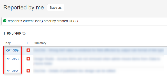

Trang Tran
March 27, 2019
try value of Key field for Parent ID
if this is still not clear, try attach a screenshot of jira ticket here
Like # people like this
Emilio Silva
March 28, 2019
Thanks, i'm try it and told you.
Like Dan Collis likes this
Emilio Silva
March 29, 2019
thanks, i've upload the file succesfully, from the options in
Settings -> System -> External System Import.
