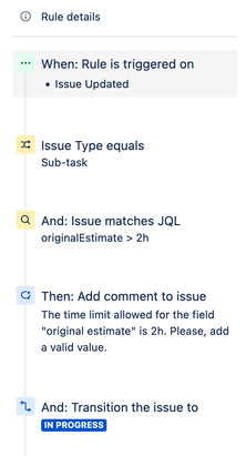

I'm afraid Jira Server does not have a validator that would prevent time tracking fields from receiving a determined value.
I believe the best option would be to use Jira automation to properly add a comment in the issue informing that an invalid value was added to the field. Optionally, you can also use Jira automation to properly transition the issue to an "Invalid status" and require the user to set a value < 2h to proceed in the workflow. These would be the steps:
  1. Ensure you have the Jira automation app on your Server site
  2. Configure a new status to move the issue to when the original estimate is more than 2h. Allow any status to transition to this one
  3. Navigate to your project > Project settings > Automation
  4. Configure an automation rule using the logic of the one below:
    1. Issue trigger: Issue is updated
    2. If: Issue type is sub-task
    3. If: Original estimate > 2h
    4. Action: Add comment
    5. Action: Transition the issue to an invalid status
Doing the steps above, the issue will be transitioned to the invalid status and a comment will be triggered every time the Original Estimate field is more than 2h, not allowing the issue to proceed in the workflow.
