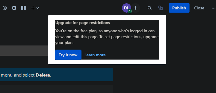

there is a padlock next to the publish button. that should work. I tried to upload a screenshot but got denied.
DeFi Logic
June 17, 2022
control.pngThere is a padlock next to the publish button that I assume will perform the function that you need. I unfortunately only have the free version so I couldn't test it.

Security levels only work if the user has at least browse access to the project. @DeFi Logic idea of using confluence may be better option

sorry for taking longer than I said. so I am admin and should have access rights control in Confluence. I'll check Jiru too. But it looks like that what you are asking is true. you can limit access to specific users in Confluence.
