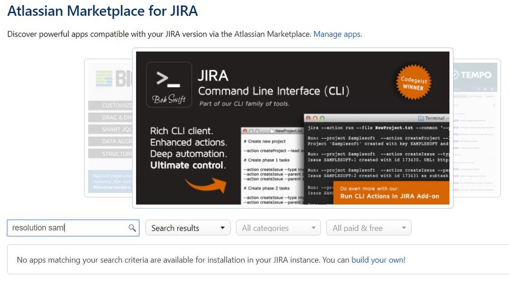

2. When I opened 'Manage apps' to look for resolution saml to install it, I didn't find it.

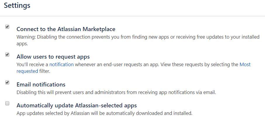

I need to inform you that the connection to marketplace is enabled as shown below.

I started to follow the steps few minutes ago, but as shown in the Prerequisites, they need Jira Core and Jira Software installed on Windows.
I have only Jira Software and it is installed on CentOS 6, not on Windows.
