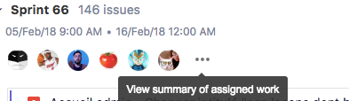

We are starting using sub-task and we noticed that the original estimate time per team members is not right. It doesn't take into account sub-task assigned to the team members.
It seems that the estimate time at sub-task level is not added to the workload of the team member who is assignee of the sub-task but well to the assignee of the task.
Are we using the sub-task in a wrong way?

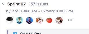

Dear @Thomas Deiler, Thanks for your answer and sorry for the delay in mine.  We are in transition towards a full agile team.  So right now, we are struggling when evaluating workload when using subtask.  Indeed, the time estimated at subtask level is added to the workload of the owner of the task and NOT the owner of the subtask.  So the workload per team member during the sprint is wrong.  Is there a reason for that or another way to it?
For your information, we click on the "dots" like in the picture below to see the workload

Christophe Fruytier February 26, 2018
We have the problem when we estimate the subtask (Original Time Estimate).  Not when we are logging work.  So user A, owner of subtask Y of the task X, estimates, for instance, the subtask to 1h.  The "1 hour" are added to the Original Time Estimate of the user B (owner of the task X) instead of it's Original Time Estimate of the user A.
So when at the beginning of a sprint we would like to have the workload estimation (Original Time Estimate) per team member, the estimation is wrong.
Do you understand my point?
Thanks for your feedback
Thomas Deiler
February 26, 2018
Dear @Christophe Fruytier,
Yes I understand. I would raise a ticket at Atlassian, to verify if this isn't a bug.
But apart from this, I cannot recommend estimating sub tasks. This doesn't make sense, if you have already estimated the stories. There is no "plus value" making hours behind a sub-task. You can log work your time.
