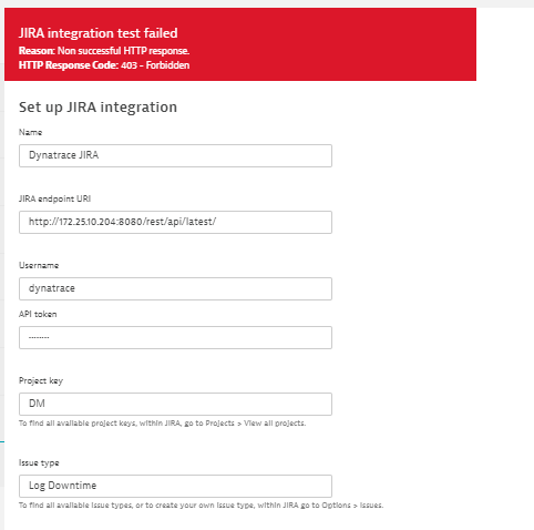

Thanks for your answer. We have tried exactly the same. PFA the screen. However, we are facing the 403 http error. Can you tell me why this error has occurred?
I have created the user in JIRA, provided the rights to create/view issues in given project.
A 403 is an authentication error. Can you use the rest api via curl with those credentials?
curl -u dynatrace:<password> -X GET -H "Content-Type: application/json" http://172.25.10.204:8080/rest/api/2/issue/DM-1Does 'dynatrace' have the right permissions in the DM project?

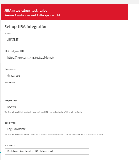

Here we are facing below issue:
The url is configured as: https://public ip/rest/api/latest
Also wanted to check on this: I have created the user dynatrace in JIRA and provided the issue creation rights. I have also created a issue in the project. Is anything missing in providing the access?
The error message "Could not connect to the specified URL" suggest that Dynatrace is unable to connect to Jira. It still looks like a firewall/port issue. You should investigated it further. First try answering the following questions:

So no response. I see that you now renamed the project to DOWN instead of DM (difference between the two pictures you posted).
Is there already an issue in the DOWN project? If not please create it and use that issue key in the curl command.
If you still don't get a proper response then you should investigate why. That is probably the rootcause why dynatrace can't connect.
