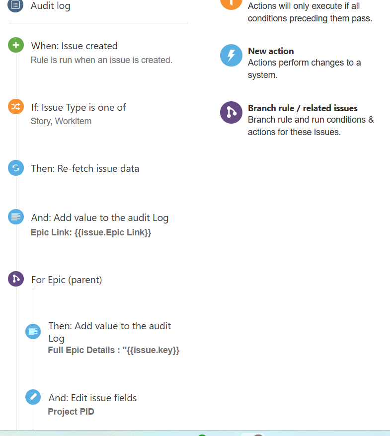

I need to create an automation rule where whenever a STORY or TASK is created, it should inherit a custom field (PID) value from its "EPIC". This requirement should work both when the issue type is created using the "Create" button and when it's created from within the "parent" issue type using the "More" option.
I have tried using an automation rule with a branch on the Epic, along with a "Refresh Data" action before the branch. However, this does not seem to work, as the automation cannot recognize the Epic Link value, likely because it's not saved yet when the automation runs.

Branching to the Epic is the wrong strategy. When you use a branch you are shifting focus to the issues you identify in the branch. The actions within the branch are taken against that issue. So the way your rule is written, you are Editing the field in the Epic, by having that Edit action in the branch that shifted focus to the Epic.
Remove the branch.

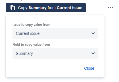

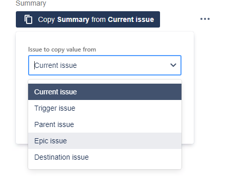

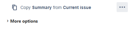

Instead, use just the Edit Issue action in the main line of the automation rule. You can use the COPY FROM option to edit the field and copy the value from the issue's parent Epic.

I already try also this way, but seems that during the story creation, the epic link is not available. I try to log but seems that epic link is not filled.

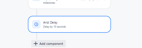

The Delay() action would have no impact on the symptom / scenario the question describes, and...
The Delay() action is only available for Jira Cloud with the Premium and Enterprise license levels.  This question is for Jira Data Center.
https://support.atlassian.com/cloud-automation/docs/jira-automation-actions/#Delay
