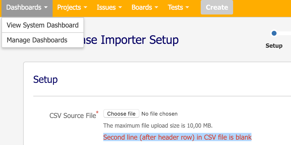

Bimleshsharma
February 20, 2019
Screenshot 2019-02-20 at 2.39.02 PM
Milan Chheda [INFOSYSTA]
February 23, 2019
That usually means the second line is empty. Either it genuinely is, or you have ended the first line with something that it cannot handle. Also, check which delimiter is used in the csv and make sure, that you choose that delimiter while importing the issues.

Bimleshsharma
February 20, 2019
Hi I tried with below template of csv.
Summary, Assignee, Reporter, Issue Type, Description, Priority
"Test issue", Bimlesh Sharma, Bimlesh Sharma, 5, This is description ,
Imported csv with following steps.
CReated Testexecution task
Test => testcase imported.
Added csv file and click on Next and i got below error.
Second line (after header row) in CSV file is blank
