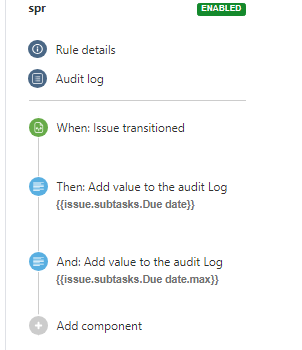

You reference it as I mentioned.. see screenshot below..
{{issue.subtasks.Due date}}  <- gives you list of dates
{{issue.subtasks.Due date.max}} <- gives you max date
Please try to log above values like I have in my screenshot to verify you are seeing the correct values and do your next steps..

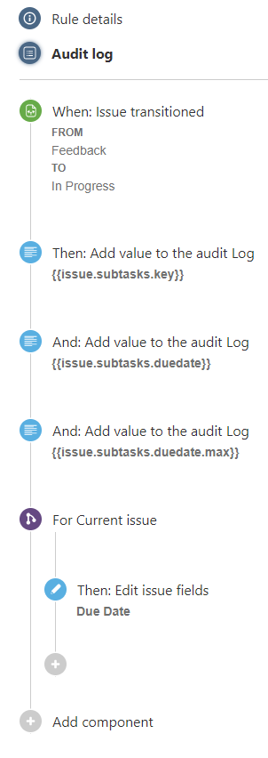

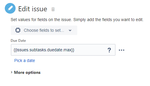

Just the very last action is NOT performed: what I need now is that the issue wich has triggered the rule gets, from this rule, its Due Date updated to the max due date of its sub-task.
See please my rule flow:
Where the Edit issue fields is:
Kalyan Sattaluri
April 30, 2024

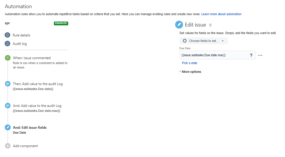

No need to do branch, just directly edit issue like below..

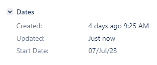

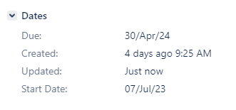

Thanks again @Kalyan Sattaluri but there is something wrong with the very last step (the Edit).
See please the Dates of the triggering issue either at Feedback status and after the transition (to In Progress); as you can see the Due Date, after the transition / and so the Edit, has even disappeared:
Kalyan Sattaluri
April 30, 2024
Hello @vincenzo.spatafora
What is happening is your smart value {{issue.subtasks.duedate.max}} is resolving to null and so your field is getting wiped out.
Have your confirmed the out put of {{issue.subtasks.duedate.max}} by logging it? Can you share screenshot?
Last time I came across such an issue helping, the poster has 2 due date fields configured.
So, instead of referencing it as {{issue.subtasks.duedate.max}} , you need to reference it by its customfield value.. {{issue.subtasks.customfield_xxx.max}}
So, first log the {{issue.subtasks.duedate.max}} value and second, see if you have another field with the same name which is null..if so, find the customfield for the one you need to use.

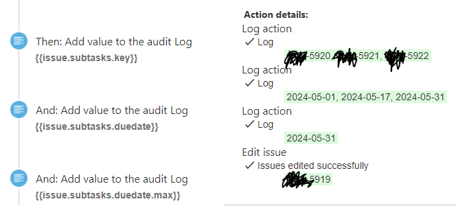

Hi @Kalyan Sattaluri, sorry to reply only now but yesterday here it was holiday.
Find please attached the log action.

vincenzo.spatafora
May 2, 2024
Kalyan Sattaluri
May 2, 2024
Find an issue where this due date field is already populated. For example ABC-1234.
Then in below URL, replace bolded parts, copy the URL, open new tab in browser, paste the URL and hit enter
https://yourdomain.net/rest/api/2/issue/ABC-123?expand=names
Then you should see JSON response. In the response, find the due date value you entered earlier. (ex - 2024-05-31)
When you find this value, see which field is it assigned to.
If it says custom field.. we need to use that field to edit your issue using advanced edit.
Please follow above steps and share screenshot of relevant section of your JSON.
vincenzo.spatafora
May 3, 2024
thank you: it has worked.
Thanks a lot for your great help.
Kind Regards,
Vincenzo.

as you were alluding, there were 2 due date fields being configured.
