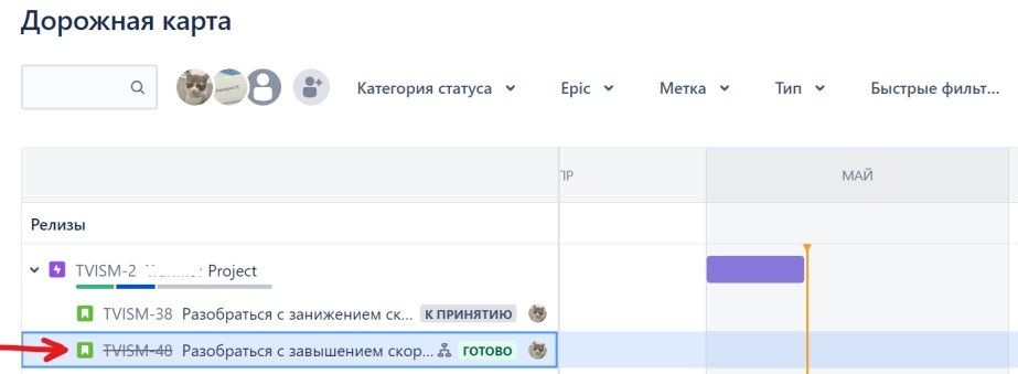

How to hide tasks inside an epic on the roadmap when completed?
Дмитрий Казмирчук
May 11, 2023
Как можно настроить дорожную карту таким образом что бы задачи внутри эпика не показывались при завершении задачи (при переводе их в статус Готово)?
How can I set up the roadmap in such a way that the tasks within the epic would not be shown when the task is completed (when they are set to the Done status)?

hi @Дмитрий Казмирчук
Welcome to the community.
You can achieve that easily by creating a quick filter and name it "Hide Completed Stories" with the below JQL
status != Done
  • You can  Create the the quick filter from the board settings
  • you can then find and use it on the board from the more menu.
Let me know if further illustration is needed
