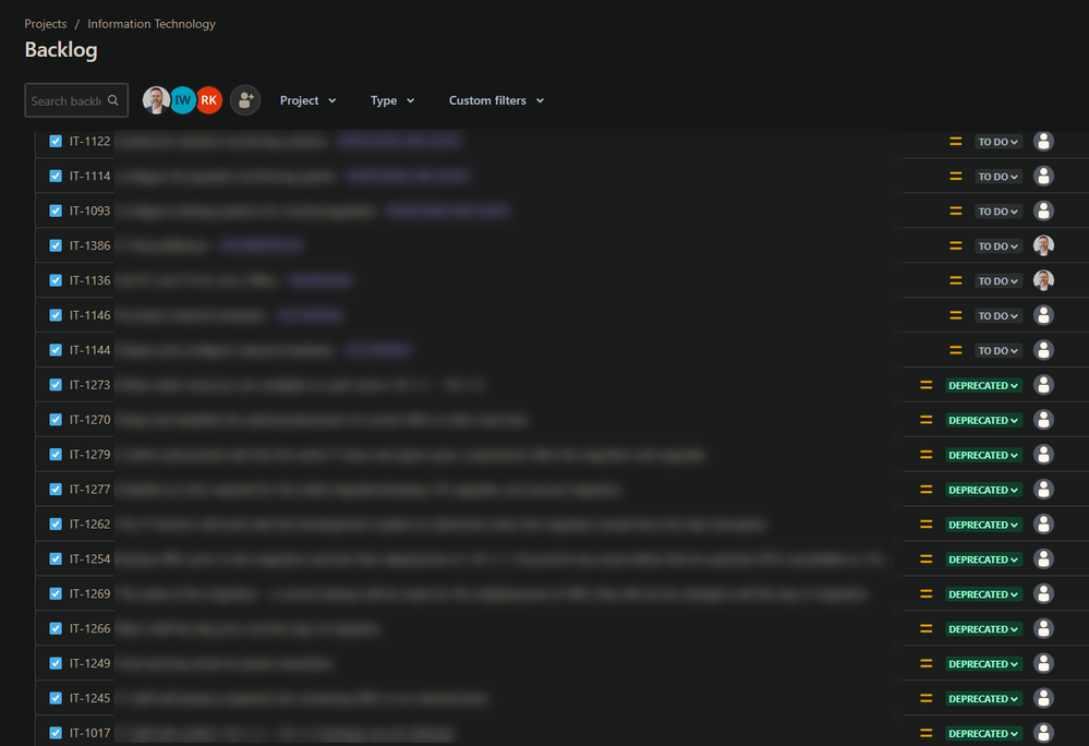

In the "Columns and Statuses" screen I have two statuses in the "Done" column: Done and Deprecated. When I view the backlog, I do not see "Done" but I do see "Deprecated" issues. How do I make these go away?
I am in a "Team-Managed Software" project.

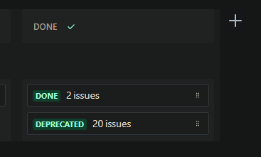

It's green, just like DONE.  Here is the board configuration:
2022-12-02 09_06_13-IT Board - Agile board - Jira and 6 more pages - Work - Microsoft​ Edge.png2022-12-02 09_07_00-Information Technology - Agile board - Jira and 6 more pages - Work - Microsoft​.png
Scott Beeson
December 2, 2022
So I tried moving them all to the board and then doing "Clear Done". Now I just have 20 deprecated issues on my board; clearing done did not clear deprecated, even though it says "20 done"
