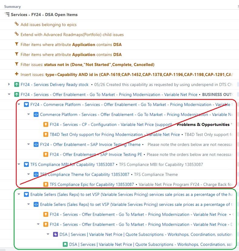

Hi,
I have this Automation on a Structure and I'd like to hide MBI/THEME/PE when I don't have Epics under them according to filters (basically: keep the green zone and hide the red zone). Does someone know how to do that? Thanks

Hello @Francois Dumas
You can try adding a JQL-based Filter generator with a query like this: type = epic and enable the 'Show all sub-items of matching items' option in the filter's configuration. The filter should work on all levels of the structure. As a result, it will only keep in the structure branches of issues that have an Epic in them as well as descendants of Epics. Structure always preserves the existing hierarchy so the related issues above Epics will be displayed since it's not possible to display Epics without them.

Francois Dumas
November 6, 2023
Fantastic!!! It works fine and simplifies the Automation. Thank you very much Stepan.
