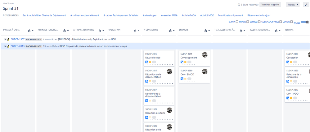

Can you provide screen images to help clarify your scenario, showing what it is you want to hide?
v01dv01d
March 1, 2023
Sure, here you go :
Our subtasks should follow the traditionnal scrum lifecycle : conceived, developped, tested, merged.
But what is shown actually is the lifecycle with our PO team : backlog, fonctionnal refinement, technical refinement, and then we go on the dev part.
What I want here is on this very view to hide the PO columns, as in a daily basis, we only work from tasks with developped status.
We would need first to rework our workflow, as what I describe is not 100% accurate to what is shown, but the idea remains the same.
I hope I am clear ! ;)

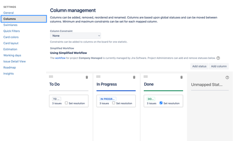

Hi @v01dv01d
As @Trudy Claspill mentioned you can go to the Board settings and change the columns displayed on the Scrum Board
v01dv01d
March 1, 2023
Hello Ajay and thanks for your answer.
In the screenshot you provide, I don't see any option to hide the column.
It seems possible to edit them, delete them, but not just hide for the scrum active view.
Can you please describe precisely where is the option to hide the columns ?
Ajay _view26_
March 1, 2023
@v01dv01d , You would need to create 2 boards with each board having the relevant columns .. So in the 1st board I will have columns - related to redacted & the other with refined.
