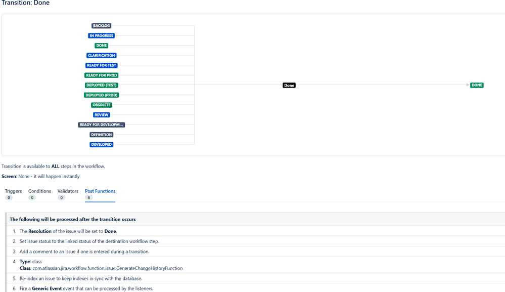

@MidnightExe,
So now how do I find the option in my workflow to add the "Set Resolution Screen", so that people are getting a popup.
 Click on any line from ALL to a status and in the popup on the right hand side choose edit. A dialog will pop up where you can change the name of your transition as well as select a screen to go with the transition.
Do I really need a post function that clears the "Resolution" field, altough I dont have a reopen transition?
If you want your Jira data to be consistent: yes. If you add a resolution to the resolution field, Jira will consider that work item as complete. You can even use that to search for incomplete issues - regardless of their status. The following query:
Resolution = Unresolved
would return all work items that don't have a resolution set and can be considered as incomplete work. But that does require you to remove the resolution from the work item any time you transition work into a status representing 'requires work'.
MidnightExe
June 13, 2025
Oh now I see, I was searching for it but did not realize that I could add the screen if i click on "edit" ...
So Step 1 --> "Adding the new screen do transition 'Done' is completed"
Step 2 --> Do I just use the Status "Reopened" and add it to my workflow? So when the issue is in status "Done" users are allowed to "reopen" the issue and if so the "Resolution" field gets cleared right?
Walter Buggenhout
June 13, 2025
The way your workflow is designed now, you can move from any status into any other status. That's what the ALL -> [status] is doing. Unless you remove all these global transitions (that's what they are called) and replace them with direct transitions from status to status, adding a reopened status would not add any value to your current workflows. People will still be able to move from done into any other status as well.
If you leave it as it is, you should add a clear resolution post function to every global transition that you don't consider as a done status. That would normally be all the statuses that have a blue or grey background color.

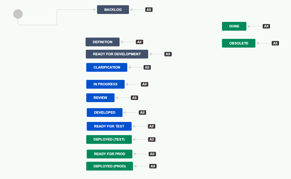

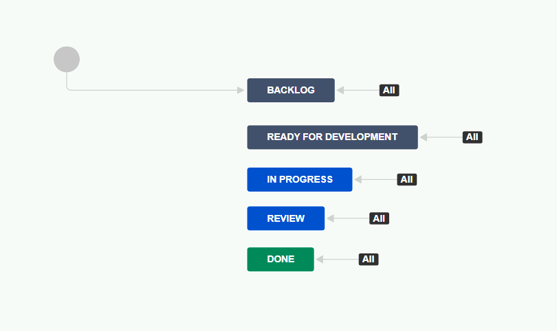

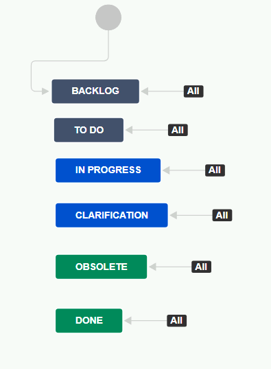

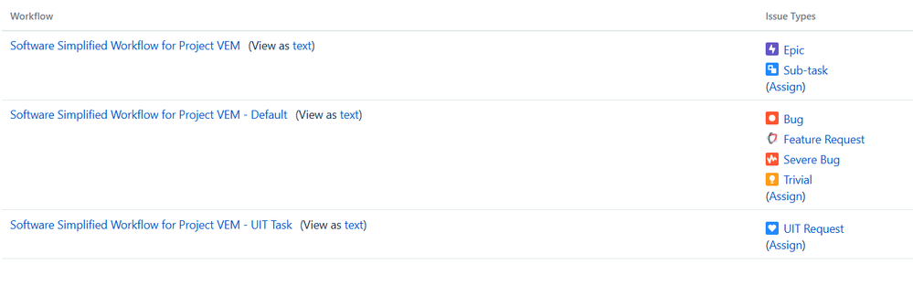

Here is my config:
