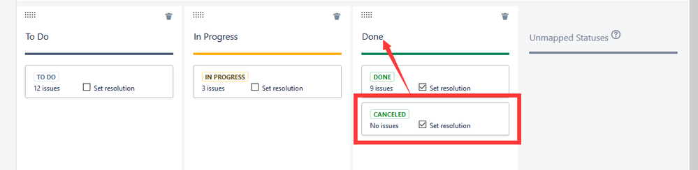

You can try matching the Status=Canceled to the Done column in the Board configuration.

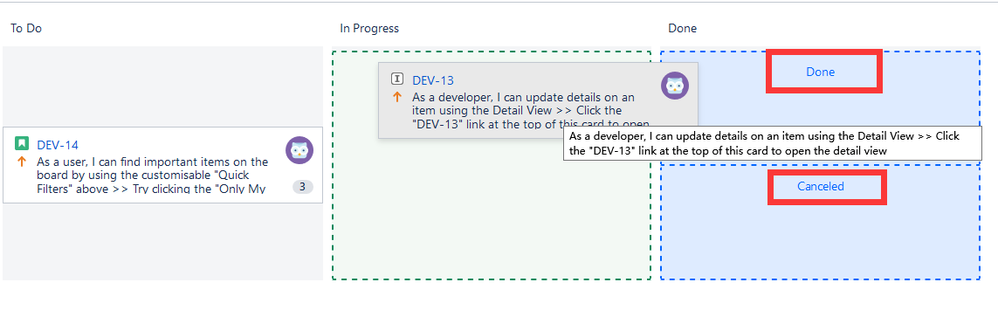

When the user moves the card, please pay attention to the final state.

How can i place cancelled within the done column?  I have it set in column management, and have cancelled in "set resolution" But refreshing the kanban board, it still resides in separate column.
Orit, you can move them out of cancelled if you place them in the wrong box. I haven't set up the boxes for that column, but i've used them. So you can definitely move them into the done box instead of cancelled if you made a mistake. Just ensure it's in the right one before you release.

@Ollie Guan So how did you get Done to appear on top of Cancelled? Mine shows Cancelled at the top which is even more dangerous
