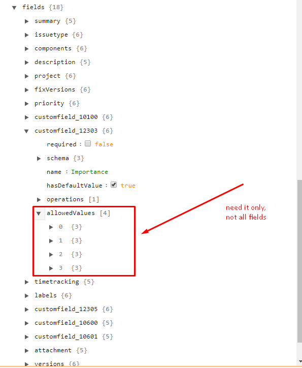

How can i change createmeta url to search values of custom select list or another list?

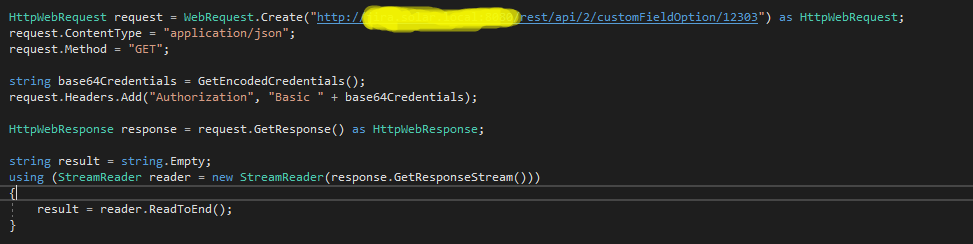

Thomas, look it
But response give mack 404 error Not Found
Mikhail Kislovskiy
February 7, 2018

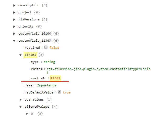

And i see in gchrome on url rest/api/2/customFieldOption/12303/
{"errorMessages":["A custom field option with id '12303' does not exist"],"errors":{}}

Need to get all allowedValues of some custom list field.
How i can do this without atlassian.jira.dll?

Need get all allowedValues of one list cutofield_10023. How can i get it without editmeta or createmeta

Ah! Now I got it:
You want to list all option of one custom field, right?
This is not possible with the current implementation of the REST API. There is no call for this. For the customFieldOption call you have to know the id, but it is at all returned when querying an issue.
Probably you can do this with this work-a-round.
So long
Thomas
Thomas Deiler
February 8, 2018
Our answers where overlapping ...
Then you can only do this:
Go through all issue and "collect" the options. Ok - if one option is never used - you will miss it.
Alternatively you can GET
https://server.de/secure/admin/ConfigureCustomField!default.jspa?customFieldId=12303
and parse the HTML response.
